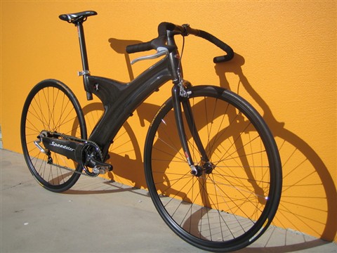

Ok here is the first build up of the new Speedster. We have taken the base frame with carbon road fork and added a super sexy set of Velocity Fusion 700c wheels in all black with Conti Force/Atack tyres. Modified a set of Truvative cranks to suit. Fitted a set of Origin-8 Gary bars. 580mm wide with a drop. Single 105 caliper on the front with aero lever. Horizontal dropouts have been prototyped and will be fitted when the new rear hubs arrive. On the way is a batch of 135mm wide disc compatable singlespeed hubs which will do away withthe need for the tensioner and let you run fixed or freewheel. More to come soon. Evan
